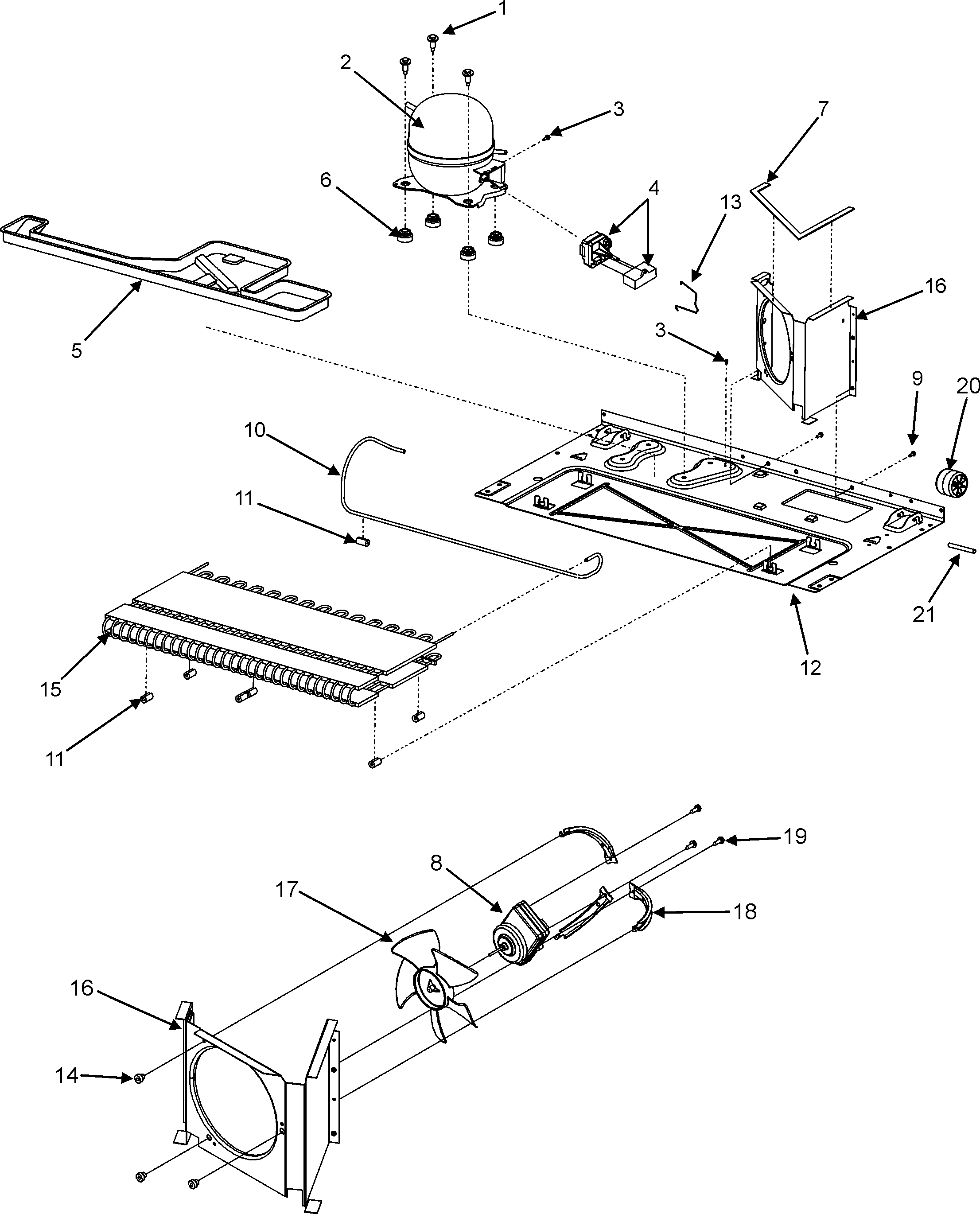

Hello, as to the condensation forming on the bottom sill of the refrigerator check your door seal for any rips tears or cuts on the lower part of the door. If you do not have any tears or cuts in the door seal the take some vaseline or petroleum jelly and lightly apply this around the entire seal make sure there are no globs of petroleum jelly also use this also in the crease of the seal as well. After you apply the petroleum jelly leave the door shut for 2 hours this causes the seal to reform and creates excellent adherence for the seal to the cabinet. And as to your question about the rollers click this link http://c.searspartsdirect.com/lis_png/PLDM/M0610330-00008.png as you can see the roller is just a simple roller with a pin through the center so it does not adjust. If you have any further questions message me back. Thanks again
