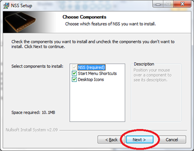

  • Click Next.
  • Click next again.
  • Click next and then install.

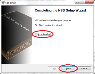

  • Please wait while the program is installed. When done uncheck Show readme file and press Finish.
  • Click No on the pop up message.

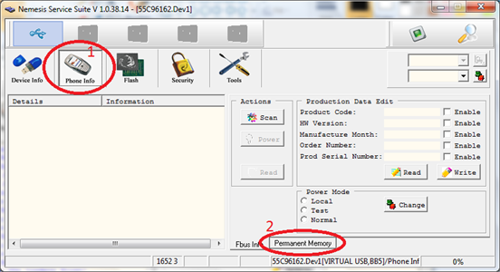

  • Please connect your Nokia Mobile phone using the cable thats comes with box. After that please run NSS from the Start menu. After the logo you ll see this screen, please click the button on the top right corner of that window.
  • Now click Phone Info and then Permanent Memory.

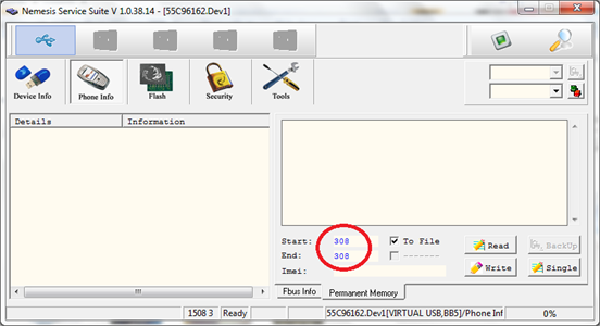

  • Change Start: and End: both to 308
  • Now please click Read button. After a few moments the process will finish, now note the address that is usually "c:\program files\NSS\Backup\pm"
